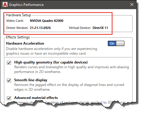

Run the GRAPHICSCONFIG command, snapshot the dialog, attach here.
Example below.
0 Me gusta
No aplicable
I have attached the graphicsconfig below
0 Me gusta
