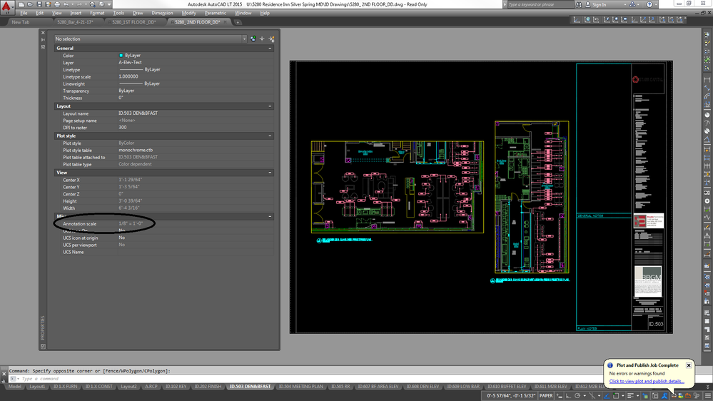

I'm in a layout. With nothing selected properties pallette shows an annotative scale of 1/8" = 1'-0". how can I change this to be 1'-0" = 1'-0"? Why do some drawings show 1'-0" = 1'-0" and some open at a different scale?

The problem here is that when I add text or any other annotative object in paperspace the scale is 1/8" instead of 1:1

Annoscale_1st Floor.pngAnnoscale_2nd Floor.pngAnnotative Insert_Small.pngAnnotative Insert_Large.png
All drawings shown are in paperspace with nothing selected. The first picture (1st Floor Drawing) shows the paperspace scale to be 1:1.
The second picture (2nd Floor Drawing) shows the paperspace scale to be 1/8"=1'-0".
The third picture shows an annotative symbol that inserts in paperspace at the correct scale of 1:1.
The fourth picture shows the same annotative symbol inserts at 1/8"=1-0".
The questions are: Why did the first floor drawing layouts come in with a paperspace scale of 1:1 while the second floor layouts came in at 1/8"=1'0" scale?
I tried using "cannoscale" to change it but that doesn't seem to work in paperspace.
I tried changing the annotative scale from the properties palette but that doesn't work.
The big mystery for me is why does one drawing show 1:1 scale and the other drawing show 1/8"=1'0" scale?
I hope I have explained the issue properly. If not I'll try again. I can work with the drawing but in the interest of learning something new about autocad I would like to know what is going on and how to control it. By the way I am using Autocad Lt 2015.

Message 16 of 16
john.vellek
Hi @clindner,
Audit found 4 errors in the file and I suspect that the 2nd layout is bad. I create a new layout, copied the content from layout 1 and it appears as expected.
