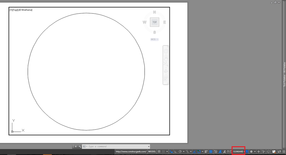

Hi @Anonymous,
When you define an annotative scale you must establish it from the list of scales, those are the predefined scales, you can insert custom scales depending on the scales you need. If you do ZOOM WINDOW will not give you result because that way not defining an exact scale, try to take that drawing to a commercial scale, or else set the scale you need and add it to the list to make it easier. For example, if ZOOM WINDOW generates a decimal scale of 0.046448, divide that value by 1, which would result in 21.52945 ..., with that value you can add the annotative scale to the list,
I attached some images to see the procedure:
Once done, you can add that annotative scale to your texts and other annotative objects,
I hope it will be useful,

Usually I recommend using commercial scales, so it is much easier and safer to scale. The commercial scales are those that you see on a scalimeter (1: 1 1: 5 1: 12.5 ....) and their derivatives (1:10 1: 100 1:50 1: 500 ....) in establishing these scales From the list you just have to enter your viewport and assign it.
One recommendation: You can use Zoom Window to have an approximate scale, then divide that value between 1 (1 / decimal value), for example: 1 / 0.020125, that will give you a value of 49,689, that value round it out on a commercial scale, for Example 50, so you have scale 1:50 and you can use it from the list.
If the value gives 45.211, also round it to 1:50 and so, because you will have many different scales, the idea is to unify the scales and use the most commercial,
