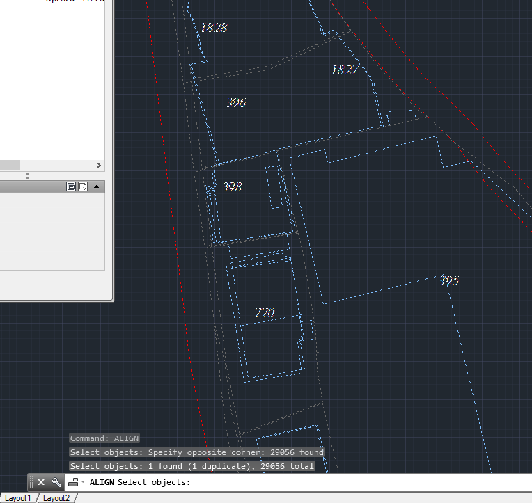

It is not working with multiple objects.

For me it can work with multiple objects.
Looking to your screenshot it says, that you have 29056 objects selected (that is like "multiple", isn't it)
Jut the last line tells you, that you have selected one object twice, that is rejected then.
