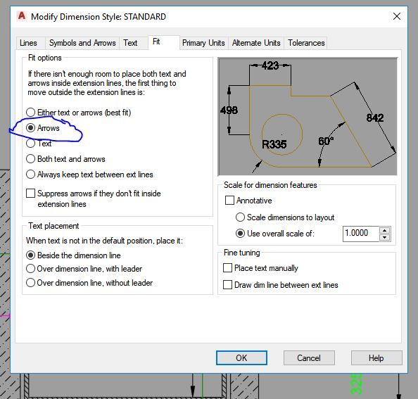

I have never put dims in a block, but to get it to work correctly I had to go into each block and change the standard style to what I have in the picture below. There is an override, but I don't know what that is. It might have just been something you tried to get it to work so I didn't investigate it very far.

Thank you for your reply.
I guess the override is something pre-existing in the block. The template (the main drawing) is given me by the client I'm working for, and I simply check for specific inserts/blocks with names (FLOOR_NULL, SIDE_B) to draw what's needed.
Anyway, I'll check if I can apply your solution in my code. Meantime though, is it not "weird" that by simply opening the block FLOOR_NULL in the block editor, changing it (I just added a circle, to test) and saving+closing it somehow refreshes the block appearance, including the dimension styles, in the main drawing?

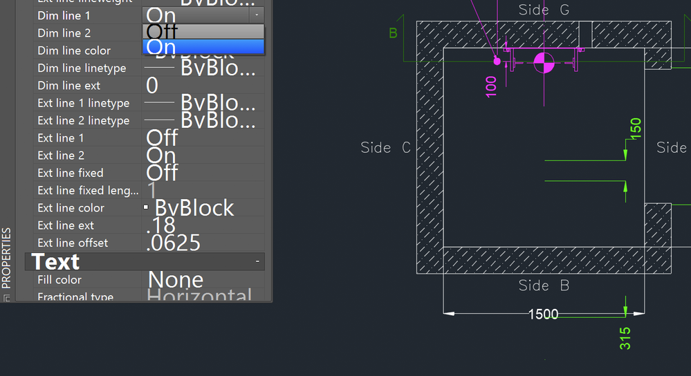

Anyway, I'm starting suspecting that the problem is (partially) inside the Cad drawing library I'm using.
I tried to move the dimension from the block to the main drawing. Also, I tested overriding some properties such as extension line suppression.
As shown in the pic below, ext line 1 should be Off, but it's visible in the drawing.
By just changing any property (even without confirming the change, just hovering over a different value for any property), the dimension "magically" updates to the right visualisation.
