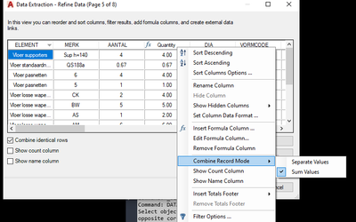

I have tried your solution, but I still see 2 rows with AE and different quantities.

Right-click the column label and choose Combine Record Mode > Sum Values. The sum of the numerical data is displayed.
Too bad it's disabled as the attribute value can't be seen as numeric.
Unfortunately you can't do what you want. If you want a custom solution feel free to contact me
