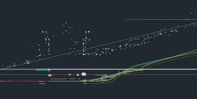

My boss had a Disto S910 gathering dust and so I want to use it like a mini total station and gather control/check points.  It can only store 30 points per file.
Here is a screenshot from the dwg wherein I’m comparing 2 files of 28 points from the Disto (blue linework; magenta Points with Orange or Red descriptors respective to file 1 or 2) against  the linework (cyan, lime, orange) from 3 Moasure captures and some white points imported separately from the Moasure's csv file converted into a script from yet a 4th test capture familiarizing myself with the device and testing its repeatability (and my skill with it, so that’s why some pathwork is so rough!).
Both the Moasure and the Disto S910 save the first point captured as 0,0,0. The Moasure then takes the next shot positively on the X Axis, but the Disto goes negative. So, the first thing I need to do to compare their information is to rotate the Disto’s output 180 around the origin.
In all but one of the Moasure runs,  and both Disto tests, I started collection on the corner or the patio where I’ve sketched a white arrow. The polygons on the south east side of the image are raised vegetable beds. Where they appear straighter to the y axis but the house is skewed, in cyan, the origin was in the north east corner of the patio but I moved the associated linework to stack the south west corner and compare like for like.
If I’m making sense, hopefully you can understand why I would want to get some control points at the southeast corner of the house with the Disto to tie the Moasure data back into correct rotation. And I want to start a new baseline with the disto to collect information at that side of the house that’s spatially closer together and therefore more accurate.
So, that would be at least 2 new series of data, also both starting at 0,0,0 that I want to transfer to different coordinates in all 3 dimensions. And I’m not sure how to go about doing that now.
For one thing, I don’t understand why the white points from my csv script came in on zero elevation.

As a retired civil engineer and land surveyor I would first ask if you have tested your measurement devices against some known measurements to see if they are both accurate?  Are your measurements from both instruments taken from the same point?  How are the coordinate systems set on each instrument?  I would guess that 0,0,0 is the instrument location but how is the X or Y axis set?

I think that the Moasure is an inertial platform, that only measures relative displacement between points whilst the instrument is switched on. The quality of data depends on the handling of the instrument, attached as it is to a stick. As all the gyros have been miniaturised, it must be a very complicated and perhaps delicate bit of kit. Each session of gathering data is thus an entity in itself, and does not necessarily relate to any other set of data, hence the need to move data from different sessions around to get an overall mapping.
The Disto S910 has accurate distance measuring but rather less accurate angle measuring. Again, each data file must be considered as a separate entity.
So it is probably easier to plot each set of data on its own, and then move each data in its entirety, using matching common points to build up an overall picture.
I would plot each set-up individually and make blocks. These can be moved in 3D and rotated to match. The blocks then being exploded when in final position.

I see that the data in the two surveying systems is different. In the Disto 3D dxfs, there are AutoCAD Points. In the Moasure dwgs, the objects that look like Points are actually 4 lines.
Keep each run separate until you have matched them up and it will be easier to Move and Rotate the whole of one run at a time. Using the correct Object Snaps, it is simple to move one lot of data to a common point in 3D.
