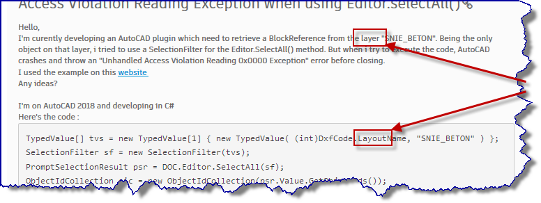

I'm curently developing an AutoCAD plugin which need to retrieve a BlockReference from the layer "SNIE_BETON". Being the only object on that layer, i tried to use a SelectionFilter for the Editor.SelectAll() method. But when i try to execute the code, AutoCAD crashes and throw an "Unhandled Access Violation Reading 0x0000 Exception" error before closing.
I used the example on this website
Any ideas?
I'm on AutoCAD 2018 and developing in C#
Here's the code :
TypedValue[] tvs = new TypedValue[1] { new TypedValue( (int)DxfCode.LayoutName, "SNIE_BETON" ) };
SelectionFilter sf = new SelectionFilter(tvs);
PromptSelectionResult psr = DOC.Editor.SelectAll(sf);
ObjectIdCollection oic = new ObjectIdCollection(psr.Value.GetObjectIds());
DOC.Editor.WriteMessage("\nFound {0} entity on SNIE_BETON", oic.Count);
concrete_plan = (BlockReference)Trans.GetObject(oic[0], OpenMode.ForWrite);

not sure about the crash, but what I see is that you one time speak about "layer" and in your code you refer to "layout" ... that are different things and maybe that already solves your issue 😉

Well, my bad. When i saw that it wasn't working with the DFX layer, i tried with layout but i ended up with the same issue anyway.
I forgot to change my code, i'll change that immediately.
EDIT : Well it looks like i can't change my original post anymore… 😕
Here's the code that i'm currently testing
TypedValue[] tvs = new TypedValue[1] { new TypedValue( (int)DxfCode.LayerName, "SNIE_BETON" ) };
