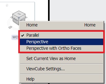

nestly2
That's just because that template starts in a Perspective view, which can't really be "scaled".  Zooming with the mousewheel is also funky in Perspective view.... it zooms the center of the view, whereas zooming in Parallel projection centers the zoom based on the mouse location.  To change, use the PERSPECTIVE command, or right click the Viewcube.

Agreed you have to change to a different view before changing to paper view and creating your viewports otherwise the viewports can not be scaled.
Yeah, I don't see it.  It should not matter which Template you start with, and it should not matter whether Modelspace is Perspective or Parallel view when the VP is created.  You can still change to Parallel anytime the VP is active and that will enable the VP to be scaled.
