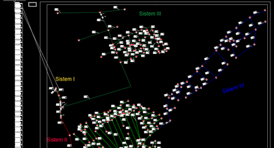

Hello, I need a help with a solution.I need a way to move a Text from specific coordinates to another known position. I know how to do it manually, but after every recalculation of network this texts require update( ussualy it is 300-500 per network). I have an excel what create me this text tables and i find a way to import them to autocad in one go, but i cant figure it out to have them automatically move to position they need to be.
As far as i see solution, it should be something like
1. First time per project i would need to find position for every table manually
2. I would write down every position where all Table should be
3. If i need to rewrite tables i would delete all old text, keeping their coordinates
4. Somehow make auto cad move newly generated tables from specific point to position where their outdates version were.
I tried to create self-renewing tables linked to excel but my autocad will crash with 300-400 links.

Hi Eugen,
I'm not understanding what your drawing is.
What do all those numbers represent: Q, L, Dn, Pf?
Where are the coordinates in your spreadsheet?
What do the coordinates represent?
Where are your new coordinates, and how are you planning on moving the leader?
Dave
Dave Stoll
Las Vegas, Nevada
NVIDIA Quadro P5000 16GB
Message 3 of 10
eugen.cobilas
Hi, thanks for replay.
those numbers are values I get from another program for my network.
Pressure, Length of pipe etc, between 2 critical points(this blocks with
numbers). I just need to have this little tables with proper information
near every pipeline. And because we have a lot of recalculation, i find
myself rewriting this tables manually, 300-450 per recalculation.
So if i could generate this tabbles automatically somehwere in my drawning
(i already know how to do this part) i could move them to specific position
where they should be. (In excel every table have its little number 1-131
for example, this is network pipelyne where it should be).
I dont know how to collect information, of their final coordinates, but so
far it is not the main issue.
I just need a way to move them all( 340-350) to their 350-400 specific
coordinates whre they should be.
It is somehow more clear now, or i need to explain it better?

There is another application that calculates what should be written in the table label. This is the reason I need to find a simpier way to update my autocad tabbles after every recalculation, to not put them manually.
