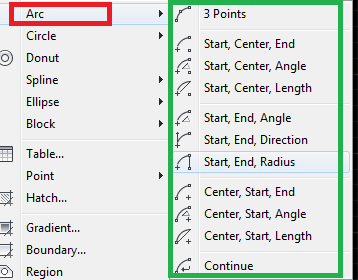

Hello, I believe I'm having the biggest brain fart of all time and require your knowledge please.
I have two known points and I want to have a radius set between them so that the radius remains the set size of 10.3mm BUT the points are quite close together and therefor a simple fillet throws up an error and trying to use Tan Tan Radius make the tangent sit further back from the desired points.
Is there a specific way to have a radius rotate or touch both points. I haven't needed to do this for a few years so I'm really empty with ideas.
The points in the blue circles are where I am trying to place the 10.3 rad. I just can't seem to keep it fixed to one point while rotating it to touch the second point.

how about using ARC options (see attached image),does it help?i suggest to use Start,End,Radius..

Draw - Arc - Start, end, radius

Many many thanks to both of you. 🙂 Spot on! Brain-fart over haha
One method I finally worked out because I forgot about the sub categories of ARC lol
I plotted Circle from one known point at 10.3rad and then another from the second point. Where they both intersect I draw the 10.3 circle tool from the intersect and of course it touched the points exactly. So old school aren't I 😞
Again thank you!!
