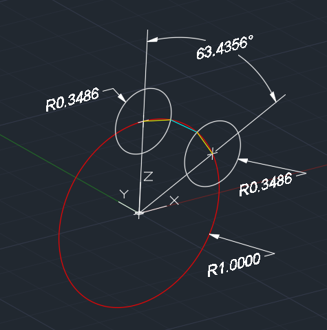

Here's one way that with this information you can construct a geodesic model in AutoCAD.
Start with a circle of radius 1.0 center at 0,0,0 on the XZ plane (set an appropriate UCS for this construction where the UCS Y axis is coincident with the world Z axis). Create a line at an angle of 63.4356° as noted below and two circles of radius 0.3486 (the length of A).
Create the yellow (A) and cyan (B) lines as shown below.
Return to the world UCS and use array polar to make a total of five copies of the 3 lines.
image.pngu

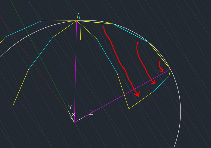

With UCS ZA set the z axis in the direction of the radial (magenta) line and then select the 3 lines as shown.  We want to use these three line (two A's and a B) to complete one spherical triangle of the geodesic sphere.
Use arraypolar with item = 2 and angle = 72° to construct the base of the spherical triangle.
Construct the 3 additional cyan edges as snapping to the ends of the 3 existing cyan (B) lines.
We now need the center point for the cyan (B) hexagon projected to the sphere's surface.  Construct a line from the 0,0,0 to the mid point between two opposing vertices of the hexagon.  Then use lengthen to make it 1.0000 long resulting in the white line below.
Create the red (C) lines from the end of the white radial line to the vertices of the cyan hexagon.  Verify that their length is 0.4124.
From here you can use arraypolar about different radial lines to complete the geodesic dome remembering that each cell of the geometry will be repeated 5 times about pentagon center (angle 72°).
