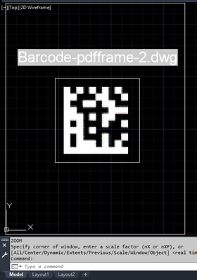

See screenshots & attached dwg & pdfs
paullimapa_3-1760462887610.pngpaullimapa_4-1760462901155.pngpaullimapa_5-1760462916727.png
paullimapa_6-1760462954008.pngpaullimapa_7-1760462976240.pngpaullimapa_8-1760462997352.png
