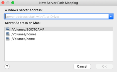

I've looked and looked, but I'm at a loss as to why I can't reference files from a shared server. Can someone take a look at my server path mapping and tell me if I'm doing something obviously wrong? I've attached screenshots of both the finder path to the files I want to reference and the AutoCAD interface.

It's not matching; the "Found At:" field is blank and the "Saved Path:" field is correct. I think the problem is in the way I set up the Mac pathing; the Windows address seems to be fine. Is there a way to edit my Mac pathing? I only have 3 options and none of them work.

It is not matching because path on windows side for some reason starts from Projects folder, which is inside homes/steveish/ssc-a folder on your "mothership3" server, but this Projects folder is not connected as volume on your Mac.
So you have to connect homes/steveish/ssc-a folder which is on "mothership3" server as separate volume on Mac. In Finder use menu Go->Connect to server and type path to server as follows:
smb://mothership3/homes/steveish/ssc-a  - verify path, I could be wrong in spelling
or use Browse button to browse to ssc-a folder on server.
Then AutoCAD will be able to find Projects folder and and all subfolders.

Thank you so much! I'm up and running.
