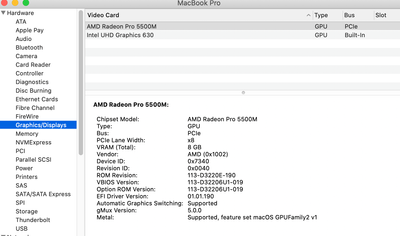

juemin.yuan
Hi Jasper,
Is your mac graphic card model is AMD Radeon pro 5500?  It is a known device driver bug introduced by 10.15.4. We need gather more information to see if more graphic card models are involved.
Juemin
Hi Juemin,
Yes below is the spec.
thanks,
Jasper 
