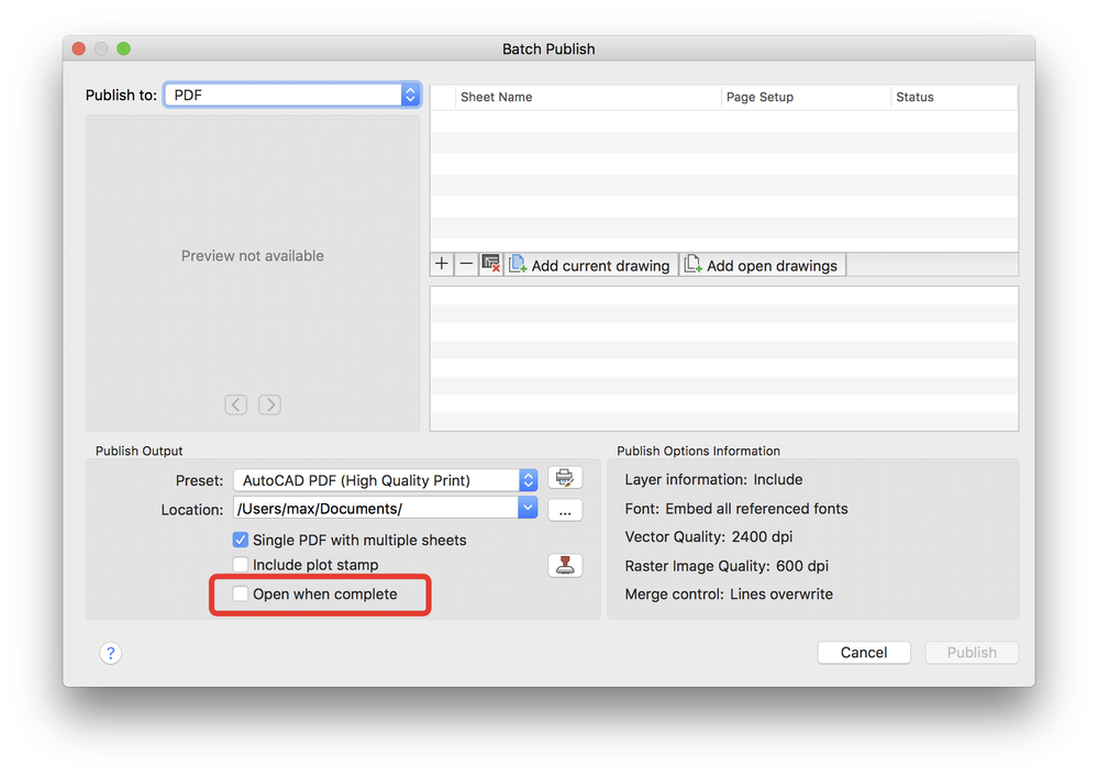

Is there any way to view pdf automatically after plottting? AutoCAD LT 2018 - for Mac.
There is a function on Windows AutoCAD to do this.

Hi Mike,
Yes, but only if you are using Batch Publish:

In the 2018.1 Update, after print to PDF, the job complete notification on the bottom left of the window contains button "Open PDF file...", which might help for your scenario. Please try it.
