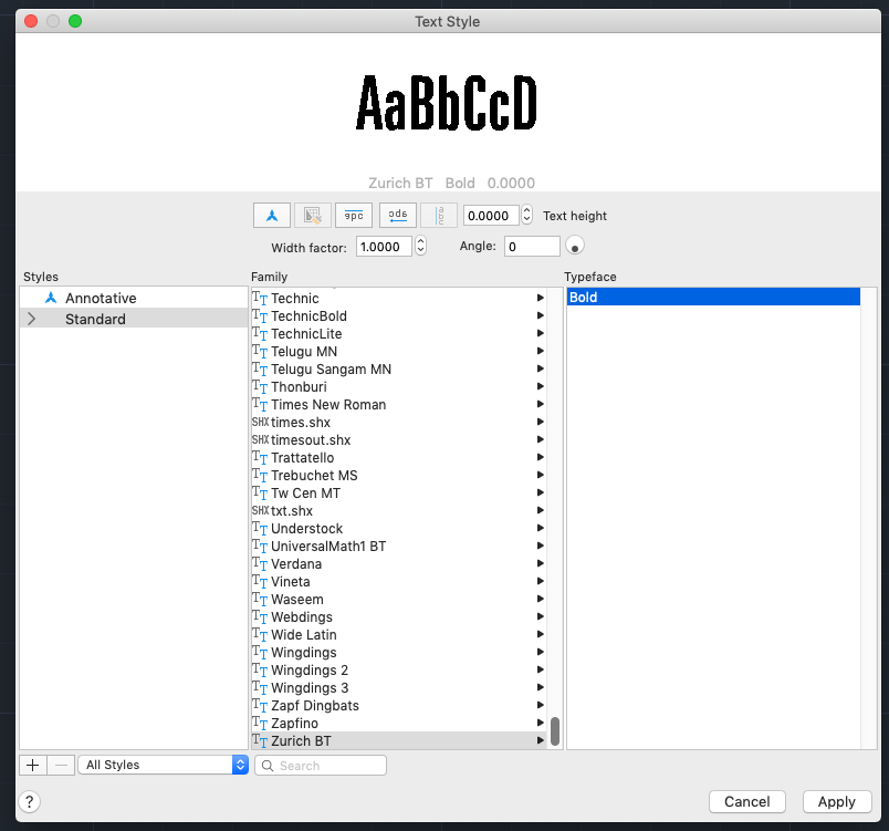

If I set up the text style on a Mac, it finds "Zurich BT" and the 'typeface' is showing as bold for some reason (it's not bold). The type in the drawing will look perfect when set up like this, but it will be broken when opened on a PC, as the PC is looking for the longer Zurich name. See the screen shot of the Mac text style editor below:

I don't have ZurichBT-ExtraCondensed.ttf font on my Mac (of course), so I cannot say for sure, but looks like Windows and macOS use information about font family name from different "place" inside this particular font.

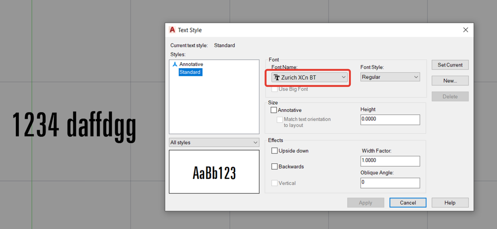

At the same time I have found a lot of examples of Zurich Extra Condensed font, which works fine on my Mac and on PC. Here are screenshots:2019-01-24_13-43-50.png
