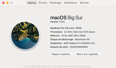

What is your exact MacOS version please?

alabrk
Hello! Here is:
alabrk
Well that was it. That solved my problem but still, Autocad should look into this problem considering the number of people that have the same issue.
Thanks for the help!
