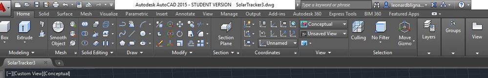

I've been using Autocad Autodesk 2015 on a windows pc and now moved over to a Mac. Downloaded Autocad 2015 (Mac version) and do not have the same menus (see below). Can anyone help or give me a link to a video tutorial that can?

I believe OP question was about Ribbon which we can see on the screenshot, and not about menubar.
If so, then there is no Ribbon in AutoCAD for Mac: Dean already mentioned - interface of AutoCAD on Windows and on Mac are totally separate and will never match.

Yes, on Mac there is a kind of "contextual ribbon panels" which appear during specific commands: HATCH (creation and edit)? ARRAY (creation and edit), MTEXT (...), etc. They are called "Visors" and are very helpful.
As about MENUBAR - there is no such system variable in AutoCAD for Mac, because Menu bar in macOS is OS specific UI element and is always visible with the exception of full screen mode, when macOS hides it and it shows only when you move mouse to the top of the screen or use Control+F2 shortcut to move focus to menubar (if this shortcut is enabled in macOS System preferences).
On the second OP's screenshot there is no AutoCAD related menu items on macOS menubar, because the focus was moved to another application (Debut Video Capture Software in that case).

While I'm at it can you direct me to where I'll find the 'view' icon, to insert dimensions from the 2D view?

VIEWBASE command is not available in AutoCAD for Mac. On Mac you can only view and print the results of Model views, created in AutoCAD for PC.
On Mac you can use only old fashioned SOLVIEW, SOLDRAW commands to create in 2D projections of 3D Solids in Paper space viewports.
