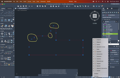

I was working before in autocad 2018 on windows and when I was useing Object Snap all midpoints and all endpoints (corners) was normally showed. But now I am useing autocad 2021 or 2024 on mac and in some (most) cases I have problem with this, as you can se in Picture 1 I have all midpoints and endpoints shown/detected, but in Picture 2 there are some endpoints/corners (in other cases sometimes also midpoints) missing/not detected (marked in yellow) eventhough that I have all functions for Object Snap truned on. And becaue of that I have a problem when I want to adjust the angles and shape of the object.

Does anyone have an idea what is the problem and how can I solve it?

Hi @BrigitaKocnik ,
What Mac model do you have?
Have you tried to change Graphics engine in AutoCAD Preferences?

Hi @maxim_k
Thank you for answer.
I have MacBook Pro M2 Pro.
I changed Graphic engine from Metal to OpenGL, but nothing changed I still have the same problem.
Is there anything else I can try/do?

Hi Brigita,
@BrigitaKocnik
Can you share the drawing with this problem here on the Forum?
