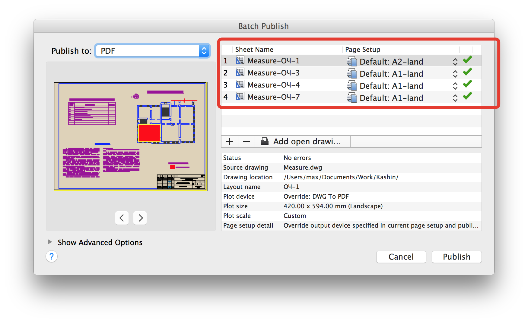

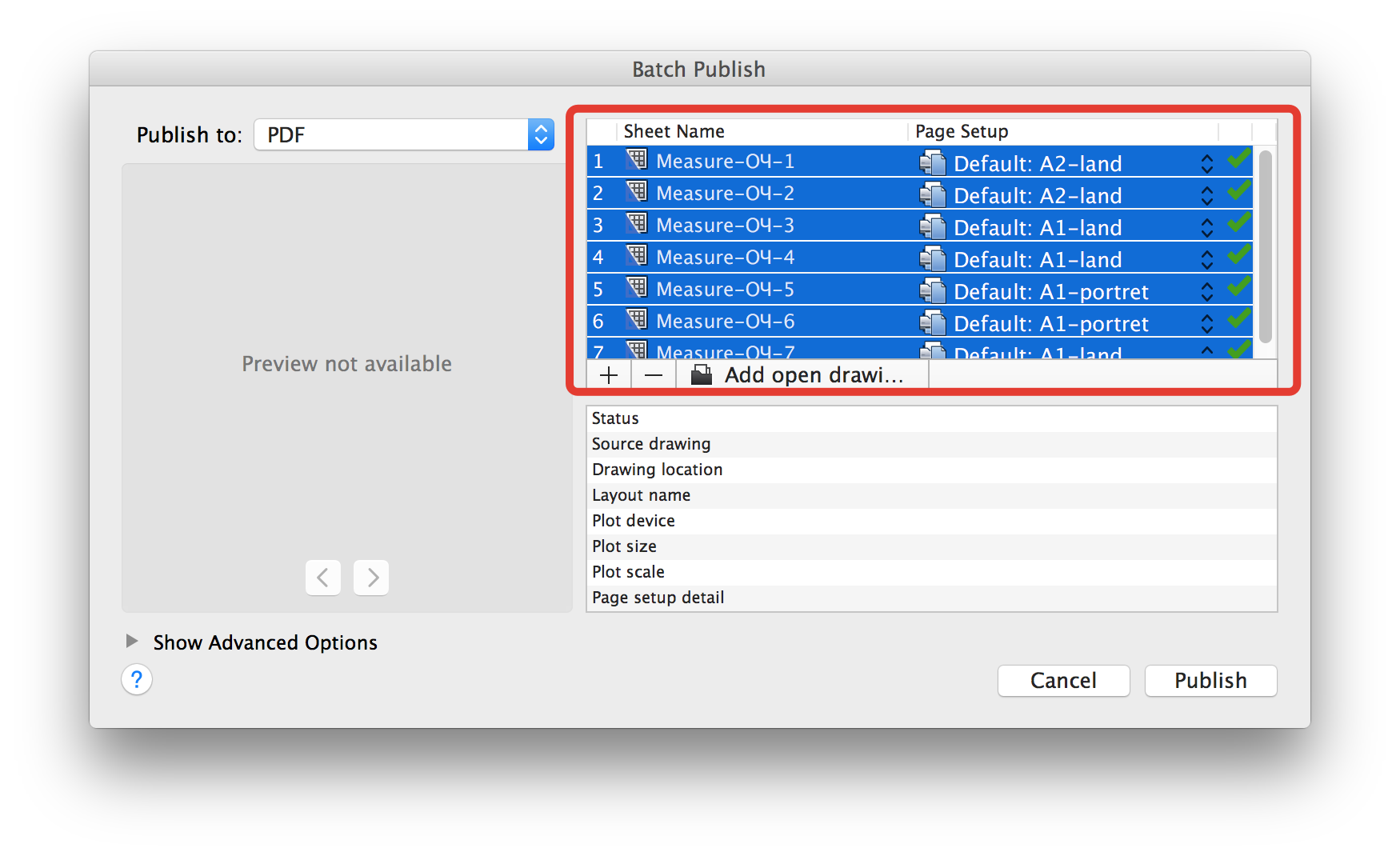

The batch publish window allows changing the page setup but I have to do it for each layout.  Is there a quick way to do this.?
- yes, select all layouts in Batch Publish dialog (with Shift key pressed), than click on Layout name in one of the Layouts and select Named Page setup you want to apply:
