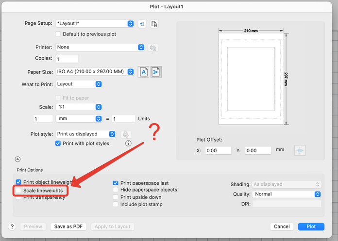

Hi-
I'm having trouble controlling my pen weights both as they show in paper space and as they plot.
I created a Plot Style Ctb file with a gradations of pen weights associated with the pen colors.
I select this when I am trying to plot.
All I see are two different pen weights and they are too crude to have the drawing appear correctly.
I do have the pen weight visibility icon checked on.
I do have the pen weight set in paper space layer as well.
I notice that the pen weight choices in the ctb file are not the same as the pen weights that are selectable in the paper space view port settings. Maybe something there?
The weights appear differently if I change them in model space but that makes it impossible to draw. I used to be able to do this but some things has changed.
Advice? Can you recommend a good YouTube on this? Pretty stuck - thanks for any advice.

Hi Megan,
@mgnrr007
How many pen weights do you assign in the CTB file? Are there more than two?
Do you have "Scale lineweights" option checked in Print Options checked?
If yes - try to uncheck it.
Can you illustrate this with screenshots?
What prevents drawing in this case? Please clarify.

I looked at the drawing you shared and, to say true, I don't see problems with lineweights when printing to PDF. From the point of view of line thicknesses, everything looks quite correct.
Maybe you have some special requirements, but I don't know them. Please provide additional information - attach resulting PDF, for example.
Another things are:
1/ The problem with displaying line thicknesses on the screen in Model space. It can be solved by disabling the display of lineweights as I wrote earlier.
2/ The problem with lineweight units in Plot Style editor - yes there is a bug in AutoCAD for Mac since 2013 (it is impossible to show lineweights in inches in it) and this bug is still not fixed :cara_de_decepción:

Hi Megan,
The lineweights you see on the screen in the drawing area are just a rough preview and are still dependent on the display resolution. That is why you do not see the difference in the gradations of the lineweights, which have a similar thickness, and the lineweights are displayed in jumps.
This has always been the case and does not depend on the version of AutoCAD.
You can see the real lineweights only on hardcopy (depends on printer/plotter physical resolution) or in PDF output (Preview button in Print window).
