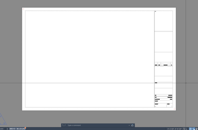

I am modifying a drawing template on a new Mac (I had previously used windows). And when I try to plot to pdf, the layout that had worked fine is off-set. I am attaching screen shots of what I see for reference. Could you please help?
screen shot 1 : view on computer

Everything seems correct on the screenshots.
Can you attach here the template drawing itself?

thank you for your reply. I saw that you had helped with similar issues before, but I couldn't figure out how to fix mine. So I really appreciate your help. Attached is the template.
