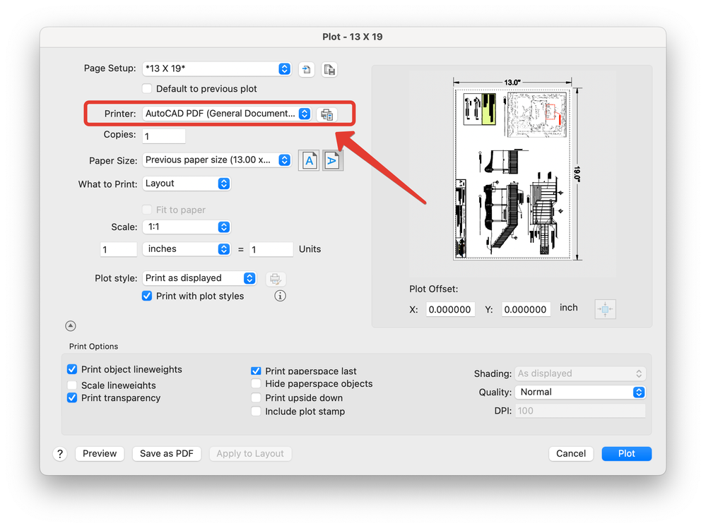

"save as PDF"? How about PLOT to PDF, your layout 13 X 19 and 13 x 19 (2) both plot fine to PDF here in 2024, no issues at all. See your DWG attached, both layouts set to PDF plotting instead of your HP device.

As @pendean mentioned you need to edit Page Setup for the layouts and set "Printer" to one of the predefined PDF printers:
 You can also try to uncheck "Print transparency" option in Page Setup.

Very sorry for my late reply.   Thank you very much for the input!  Your solution worked for me. ( it is cutting off the border, but I can live with that). I tried messing with the margins to no help.  Your solution is different than I have done, but it works!  I was able to get it to my customer.   Thank you!!
I suppose I have been doing it wrong for a long time.  I will look further into getting it to keep the border.
