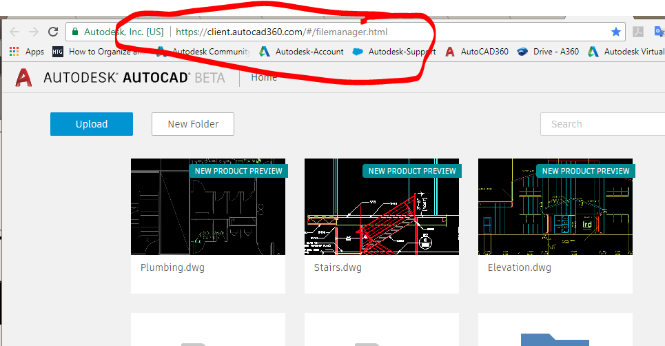

In fact Safari is supported for using AutoCAD360:
Yes, when you open https://client.autocad360.com/#/filemanager.html  for the first time, you will see:2017-10-18_10-06-26.png
If you will pick on "Get Chrome", the new tab will open - just ignore it and close.
In the initial window you can login  and will see all your uploaded files.
Now click on uploaded 2018 format drawing, this should bring you to the Editor.
Looks like on Safari it should opened in the "old" version, if so you can use this button to download DWG in preferred format:2017-10-18_10-21-36.png
When you are using Chrome browser, the Editor opens in "new" (beta) version for the first time, where downloading with DWG format conversion is not available (maybe it will be added later, don't know exactly). So you need to use this link:2017-10-18_09-56-36.png
 To go to "old" Editor, where you can convert your drawing the same way as in Safari:
HTH

Thank you for the step-by-step, Maxim. That filled in the blanks for me, and I was able to get that to work just fine. Now that I know to either fake it out about downloading Chrome or to go ahead and use Chrome but with the previous version. I really appreciate the thorough response.
I'm not sure why AutoDesk has decided to make this such a convoluted process, and I certainly hope that they don't kill off the "previous product" before they add the conversion functionality to the new product, but for now at least, this work-around works.
