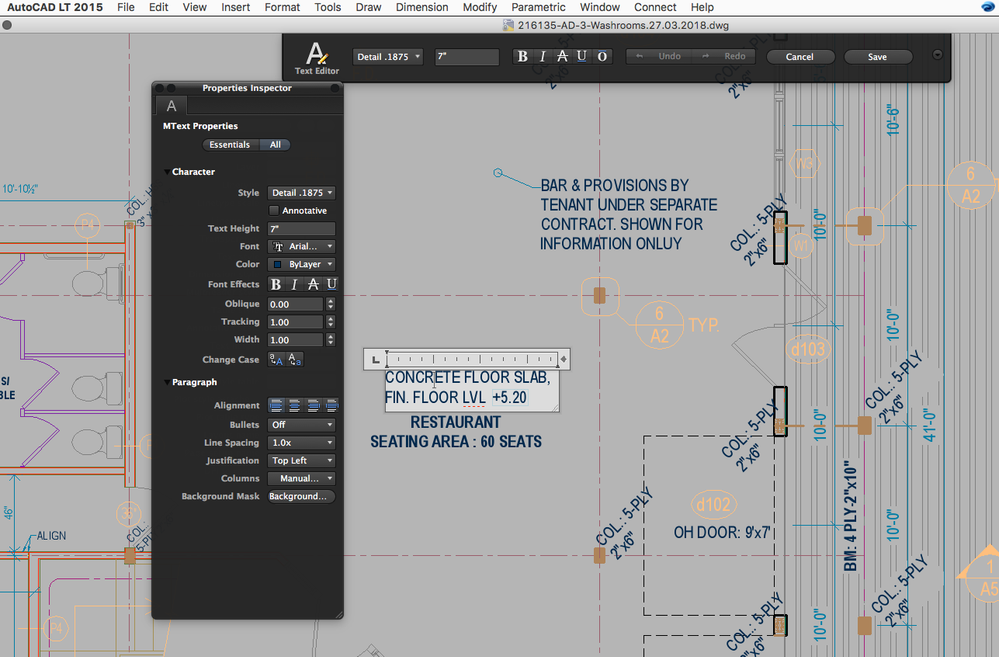

Thank you for the reply! However, I'm inserting some photos for you to see the difference between what I see with my ACAD 2015 LT and the 2018 LT. They are definitely not the same. I'm just not sure if this is a down-grade to the LT version for MAC, or if I have to change some type of setting?
Below is ACAD 2015 LT Properties palette in the Mtext editor:
In this version I have access to the Properties palette 'All' and can control Oblique, Tracking, Width, Justification, etc. for each word/line if need be.

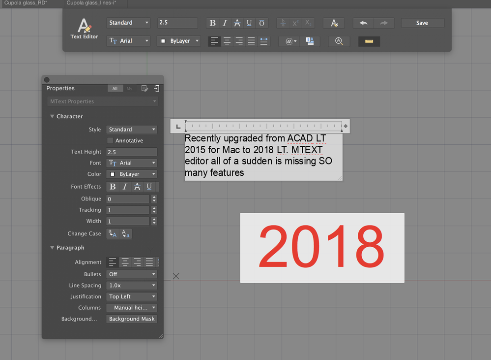

But, below is what happens if I open the MTEXT editor within the ACAD 2018 LT:
I cannot access the 'All' tab in properties anymore. It becomes disabled. AutoCAD won't allow me to switch between the tabs and I get only this limited selection of options for editing the text. If I single-click on the the text without opening the MTEXT editor it allows me to access 'All' in the Properties palette. This allows me to change the justification, however I still don't have access to Oblique, Tracking, Width, etc. features of the 2015 LT editor and anything I do has to be done to the whole piece of text.
Is there are any to change access to the 'all' tab with the MTEXT editor open? Is it a setting? Or is this not possible in the LT version I am running? Any information is helpful here, thank you, I appreciate any feedback.

maxim_k
I tested AutoCAD LT and everything is OK with Properties palette:2018-05-11_10-02-23.png
I'm able to switch to "all" tab and edit MTEXT properties.
