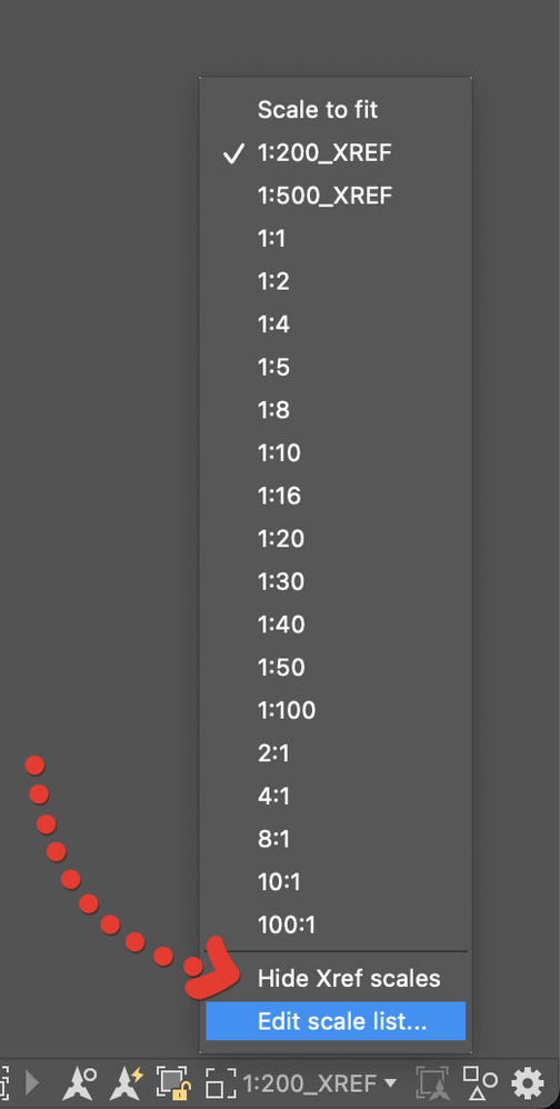

You can:
- attach drawing with your custom scale list to the drawing you want to import the sheet into.
- detach this Xref.
- uncheck "Hide Xref Scales" in the list of scales on the Status Bar:
- use imported scales - you can also edit their names after detaching Xref
