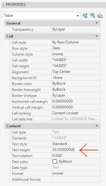

jvgerwen-PlantLab
Answer to my own question::cara_que_sonríe_con_ojos_sonrientes:
Select the cell in the table at the bottom left of your screen.
Hold down the SHIFT button and then select the diagonally opposite cell within the table.
You can now change the text height by properties.
