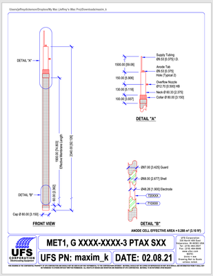

gobluejd
Almost there!!!  2 things - It is not printing correctly.  See attached.  The QS PDF does not have correct print.  I also attached what it should look like.  Also it appears to not be able to save.  Is that possible?  Again thank you for your time, it is greatly appreciated.  I finally want to move completely to the MAC side.  
0 Me gusta
maxim_k
You need to edit Page Setup in template drawing (or in each drawing you already have):
1 - select "AutoCAD PDF (General documentation).pc3 printer
2 - activate "Center plot" option as you are using "Window" option for "What to Print"
I attached your template with modifications.
Yes, it is. I uncommented
(command "_.qsave")
in QS.LSP and now it saves drawing after export to PDF.
