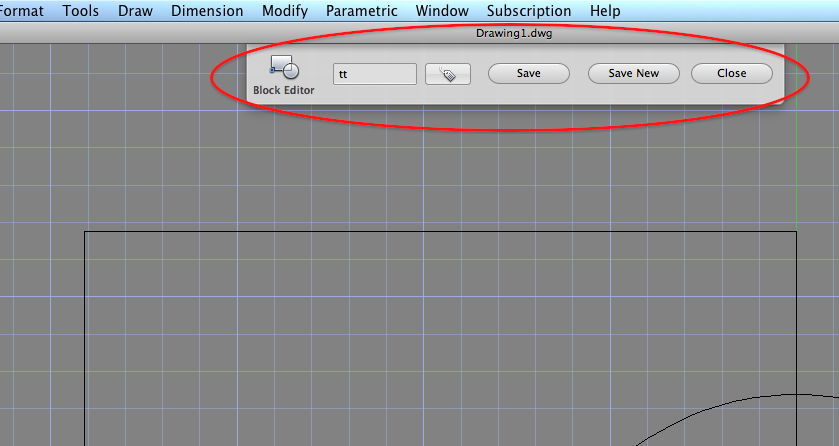

If sort of have the same issue so i thought i post it here instead of making a new topic.
When i make a block, and then edit the block later on. the "block saving window" as described above is missing, so i have to save the document and than quit it to get out of the block editor. It doesnt happen all the time but about 50% of the time.
(see attachement)
The funny thing is that when i CAN save the block after editting, i return to model space and than the "block saving window" is just staying there, without any blocks that are being edited. It also doesnt happen all the time but about 50% of the time.
(see attachement)

maxim_k
in reply to: Anonymous
Hi, before reinstalling, you can try:
1. Reset Palettes from Window menu,
2. Reset Application options from Application tab of AutoCAD preferences.
Maxim

in reply to: maxim_k
Thx maxim!
But sadly both options didnt work, and i had to reset all toolbars etc. so time consuming and to bad, not working Smiley Sad
Its not the biggest problem to cmd-Q everytime to exit the block editor but it would be nice if there would be a fix in the next patch. I also experience some problems with zooming out in model space, it gets stuck so i have to [zoom]+[all] about every few minuts. but thats a whole other problem
