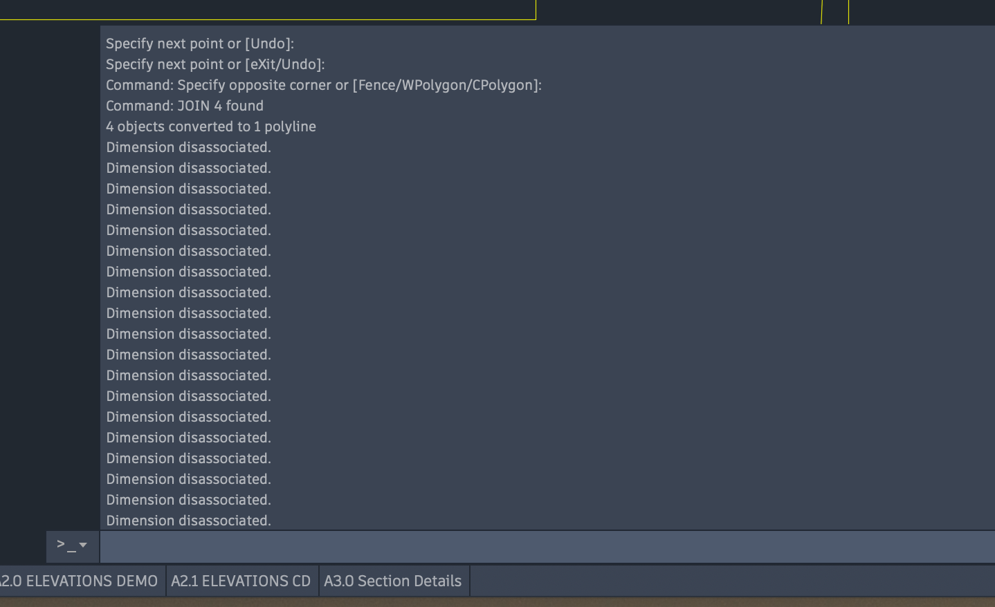

Since upgrading to AutoCAD for Mac 2020 I regularly get the message "dimension disassociated" when using the DI(DIST) command. Repeat the command and then the command works and I get a dimension. Is this a known bug? It happens nearly every time I make a dimension query and is wasting productive time. I've never had this happen with any previous version of the software.

I also just had the same thing happen when I did a JOIN command. (Screen Shot attached). Just like with the DIST command, the command actually works but is followed by the words "Dimension disassociated" multiple times. This results in hiding the command result, making it appear not to have carried out the command.

Hi Maxim,
I reset AutoCad, as you suggested, and it seems to have taken care of the problem. Hopefully the glitch is gone. Thanks for your help.
