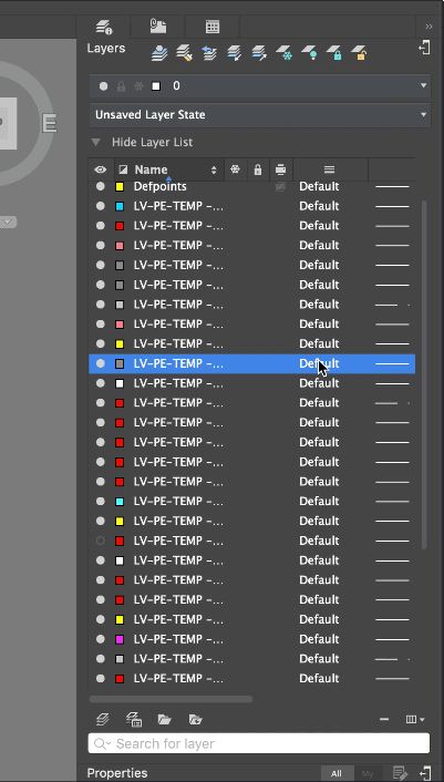

Here how I do this:change color.gifchange color.gif
Can you try such a way?
