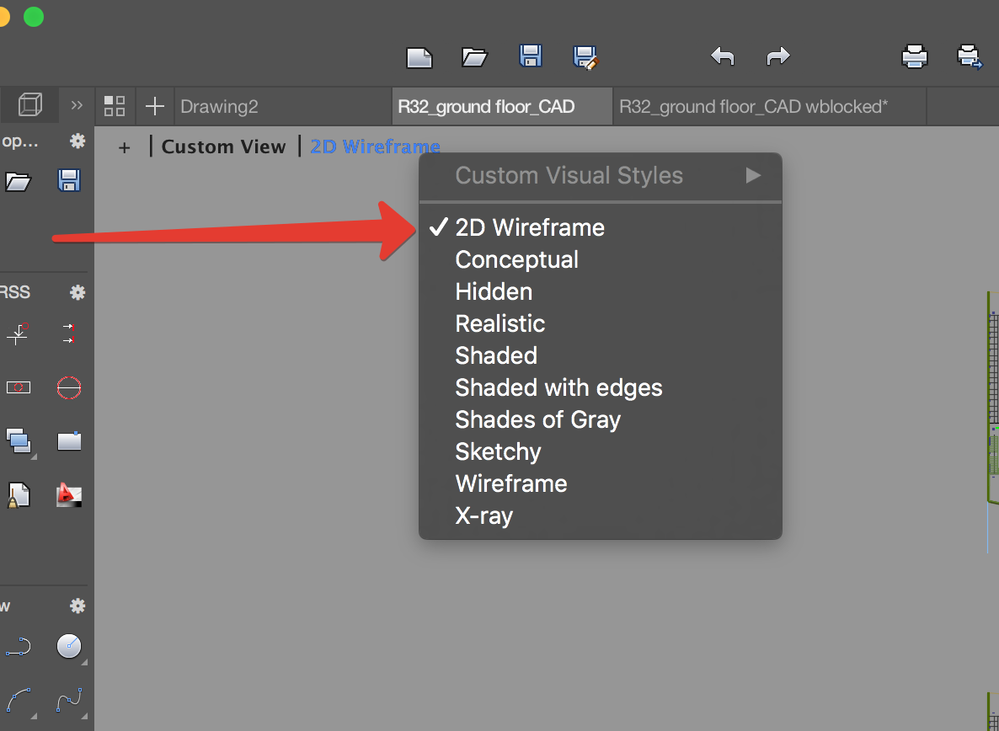

maxim_k
Solución aceptada
Hi Justyna,
I opened your file on my Mac and, it seems to me, I figured out the case of the problem:
For some reason the current Visual style in the drawing was different then 2D Wireframe, which only one is suitable for complex 2D drawings as yours.
After I switched Visual Style to 2D Wireframe:
the performance become acceptable.
Maxim
Maxim Kanaev
Architect
MARSS
MacACAD | Linkedin
No aplicable
I would never guess it myself!
Thank you so much Maxim!
Regards
Justyna
