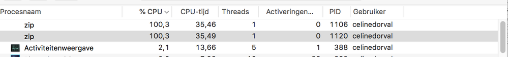

unfortunately the resetting doesn't seem to resolve the issue. I also noticed that the CPU is exceeding 100% when it crashes (see screenshot). Do you have any other solutions that I can try? thanks for the help.Schermafbeelding 2020-05-12 om 13.29.02.png

This could be macOS High Sierra issue, but I'm not sure exactly.
Does it crashes if you launch AutoCAD and start to work in new drawing? If yes - how long you can work in AutoCAD until crash?
