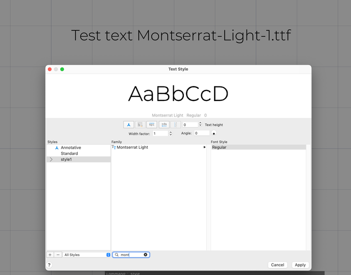

If you need Montserrat-Light.ttf -  look >>>>HERE<<<<
Renaming "Preferred family" to Montserrat-Light works for me fine.

Hi @annieH5CZ7 ,
Have you tried downloading the font archive from >>>>THIS<<<< post?
I checked it just now and was able to use Montserrat-Light-1.ttf font from this archive in AutoCAD.
You need to download the archive, extract TTF file from it and add it to Font Book.app. Don't forget to relaunch AutoCAD.
