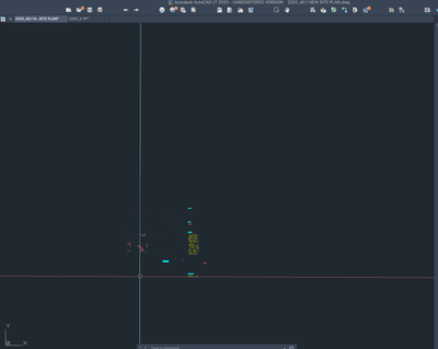

Hello, I desperately need assistance! When I open any 2D drawing, even the  sample template drawings from the  Auto Cads 2023 own pull down menu I can not see the drawing, just little grainy pieces. I am able to select them and see that every thing is there. See images.  First image is what I can see (and I have to zoom far out to even see much)  . Second Images is the same drawing, It is what I see when I select it. Is anyone else having this problem?? I had this same problem on both AutoCad 2023 and AutoCad 2023LT.  Thank you for any help!!

Hi @studiospears ,
Could this be related to the color of the objects?
Can you share (attach here) the drawing itself?

maxim_k
@studiospears
You may also use SHADEMODE command to check the shading used in the drawing.
Try to set shading to 2D Wireframe.

Message 4 of 9
studiospears
Shademode worked! Although, when I selected> hidden option the drawing appeared. I still however am having the same problem on the same file when I plot . I feel like I am having a problem with some kind of 3D issue or toggle. These are 2D drawings that I prepared on the 2021 and 2022 versions.  I have gone over all by .ctb files and settings... something is just not making sense!  Thanks for you help

Hi @studiospears ,
You also need to check SHADEMODE inside viewport on the Layout you are trying to save to PDF.

studiospears
@maxim_k how do I check shade mode inside the viewport and layout for PDF.?  I tried to do it in paper space and command line said "Shademode" is only applicable in model space.

Hi @studiospears ,
Thanks!
You need to activate viewport on the Layout to change SHADEMODE inside it.
