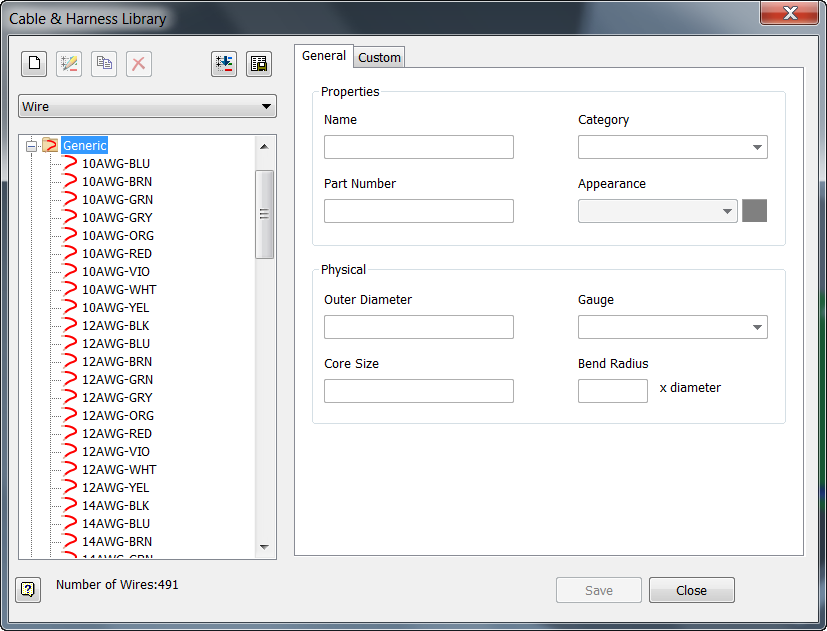

Before Making new parts with pins fix the library.
I like to Modified the Cable and Harness Library stored in Inventor, because I like to see my wires setup as Colour_Gauge.
Inventor stores all wires as Gauge -Colour... which blows. (you can switch acade or inventor just make sure they match.)
All of the electrical components in Inventor have to include "Pins", which act just like a terminal it ends the wire connection.
So you need to have both PIN1 (component 1) and PIN2 (component 2) created with pins to get a wire.
If you have the components with pins, then you should also create wire segments (like a Cable or a Harness!... to route the wires.
Segments are extra fun because they are literally just 3d points in space that the segment forms around.

I actually posted a question similar here in the inventor forum and there wasn't much of a response, I think the inventor forum has more mechanical guys than electrical.
Anyways, the info you have posted will get me going in the right direction. I think a training course is required though, I understand what you have said, but if I had a better understanding of AutoCAD Electrical, this would probably help the process.
Thanks for your time and reply!
