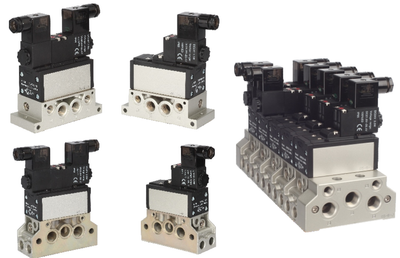

Thank you for your attention, I want to create the symbol of the valve mainfold, which consists of multiple solenoid valves assembled together(the dash line in the photos), which share a pressure input or exhaust port。
