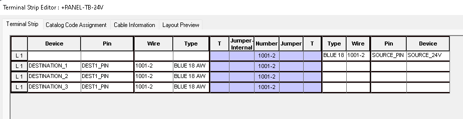

I have been battling with a very simple task with regards terminal strips.
I want to have a bank of common terminals, jumpered together e.g. +24vdc, 0vdc.
I draw these on the schematic and they look as I intended, when I open the Terminal strip editor, the terminals are all looped together.
Please see the attached pics.
It makes sense that this happens in the software but in the real world I want the jumper to be the 'Loop' and the terminals to be fully populated so I can add my own spares.
What I am asking is for suggestions on how to manipulate the Terminals on the schematic/TSE, OR do I need to change my approach?

Create a new wire layer called JUMPER or include the word JUMPER in a wire layer and assign that new wire type to your power rail. The word JUMPER is ignored by TSE. Let us know if that gives you the desired results.

Thank you @trabuck7, this seems like a straight forward solution. I was unaware of the JUMPER method.

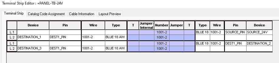

First, create a new wire layer, color it to something else that stands out and name it "JUMPER". Attribute the wires that represent the internal jumpers of your terminal strip. Like this:
Just by doing this, you'll notice TSE will instantly remove those redundant representations:
Of course, it's not smart enough to represent the actual jumpers, it's a step you need to manually perform (although it's not 100% necessary nor much useful, you could skip this):
still, it is using/calculating four terminals where you'd actually need only two (this error grows geometrically as your project can potentially have hundreds of terminal blocks.
The way to trick ACADE here is to upgrade your terminals to have levels that are equal the number of connections
This means all "single tier" terminal blocks would be a "2 levels" block. "Double tier" terminal blocks would have 4 levels:
Change this on the first block and copy/paste its properties to the other ones. You'll see now that each line represents not only the wires but also the different levels on each block (L1, L2, so on)
Now that we have two level terminals, we can use the "assign" tool to glue each two terminals together. You'll notice the terminals that lose the assignments become empty, or "spare" terminals. You can use the remove spares to get rid of them, or just reorganize everything by clicking on the table columns or manually moving them up and down.
Assignments done. Now delete the spares:

This is enough detailing for ACADE to correctly calculate the number of terminals your electrician needs, as well as represent them flawlessly on both your schematic and footprint pages:
