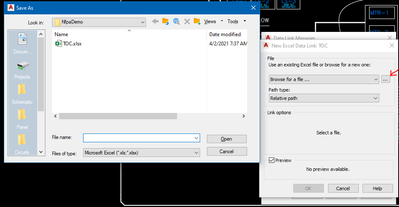

Don't give up! Even though many have wondered why AutoCAD Electrical doesn't have that feature built in you can still use AutoCAD Data link feature to update a TOC from an external Excel file.
Create a TOC.xlsx file an put it in your projects folder
Create the link using the manager.
Use relative path that will work best IMO.
Pick the file you just created and this will establish the link. You will have to select OK a couple of times.
You then just need to add the table to the drawing.
Select you data link and put it in your drawing.
That's it easy peasy.
