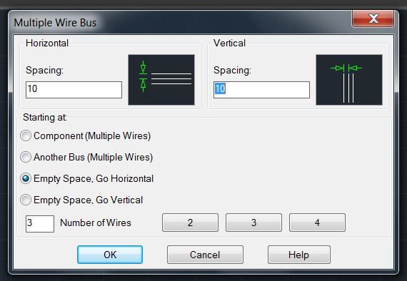

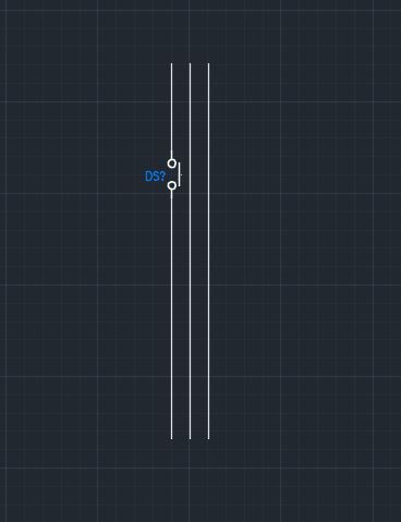

As per your instruction  i went on to create the symbol and found success. but now the problem i'm facing is when i insert my 3ph custom symbol on 3 phase wire, symbol doesn't match to wire spacing [either it may be in horizontal or in vertical]. what might be going wrong this time..??? Help me out... down i have attached pics both in horizontal and vertical Capture-1.JPG

This is a common problem with users...
The main cause is a scaling mismatch in the drawing settings.
Go to the drawing Properties and swap to the Drawing Format tab.
In the Scale section make sure the Feature Scale Multiplier is set to 1.
Select Inch or MM Full Size depending on your local standards.
From the fact you have the Wire spacing set to 10, you probably want the scale set to MM Full Size.
Click OK to save and exit.
Try inserting the block again and let us know how you get on.
One thing to keep in mind is that the different symbol libraries are also drawn at different sizes to match the general measurement standards of the relevant country. For example,  the symbol libraries used in the US are drawn in the Inch scaling while European based libraries are drawn in the MM scaling to suit the appropriate standards.
Make sure that you are using the correct library to suit the scaling you have selected.

As per your instruction in "drawing format" i changed scale from to inch to mm full size but still i'm facing problems in placing any symbol either it may be from pre installed symbol or custom made... Help me out in this sir,please....

A quick look at the Drawing Format tab reveals that while you changed the scale, the wire spacing is still setup for INCH.
 A good spacing for mm is 15mm minimum for the ladder & Multi-wire spacing and the width sized to fit the title block you are using.
Try changing those settings and see if it works for you now.
Also, if you are still having problems with ACADE not finding the blocks when trying to insert using the WD_3UNIT command, make sure the icon you added to the Icon Menu is for a COMMAND rather than a BLOCK. I got caught by that when I tried to add your icon to my test menu as it's been a while since I did one.
Once I had those fixed, I was able to insert a 3phase multi wire and then the blocks inserted & lined up properly.
Although I did notice that the Link attributes are in different positions between the Child and Parent blocks. They just need to be aligned properly but are not block breaking.

I've attached the two Horizontal blocks with the LINK attributes lined up in the centre.
Compare them to the originals you have by inserting the originals with a linked line and then these two with a linked line and you will see what I mean about them not lining up properly.
The attachment points for the X#LINK and X#TERM?? attributes is the INSERTION point and it's generally best to use the generic left insertion for these attributes.
