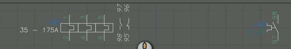

Hello everyone.  I am having an issue with AutoCAD Electrical 2017.  I am using symbol builder to create an IEC symbol for an electronic overload relay with a NO and NC contact.  When I try to either run the symbol audit tool or try to close the block editor and save the symbol, I keep getting one error.  It is under Layers and the error is LINK.  I've tried researching this error with no luck.  I have attached a photo of what I created and the error report that comes up.  Any solutions or feedback that you may have would be greatly appreciated.

Thank you.  I thought that I needed to clear all errors.  The only thing is that the symbol is not scaled like the other symbols in the library.  It is huge!  I also cant place it on the correct phase of my vertical bus.  It just shows up outside of the title block.  Thank you.

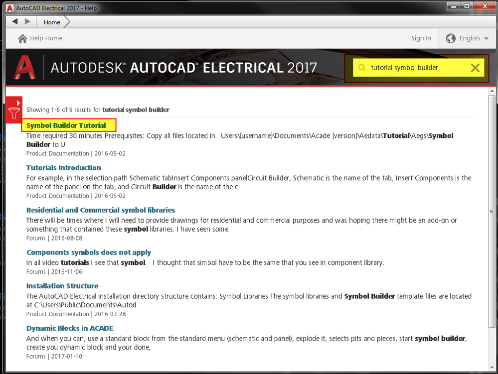

If you have the time, it would be worth it to take a few minutes and take a look at ACE Help ...
Good luck
Screenshot - 3_28_2017 , 1_35_41 PM.pngScreenshot - 3_28_2017 , 1_36_30 PM.png

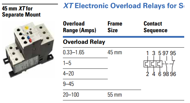

Thank you for your response.  The symbol that I am trying to build is a specific manufacturer component.  We are trying to map this part number to a symbol that is representative of it.  Can this be accomplished so that the overloads are the parent and the NO, NC contacts are the children?  In a single symbol?  We would also like for the correct pin connection numbers as shown in photo to show up as well.  Thanks.

Good morning Trond.  Your tutorial worked great.  The only issues I am having is that my NO & NC cross referenced contacts do not show up to the right of the overloads like yours do.  Secondly when I insert the overloads I get the rating attributes displayed across all three overloads.  Can you provide a solution to resolve these issues.  See photos below.  Thanks.

rhesusminus
In the parent symbol, I've moved and rotated the XREF attribute to the location where i want to see the contacts.
In the child symbols, set the RATING1 attribute to invisible
