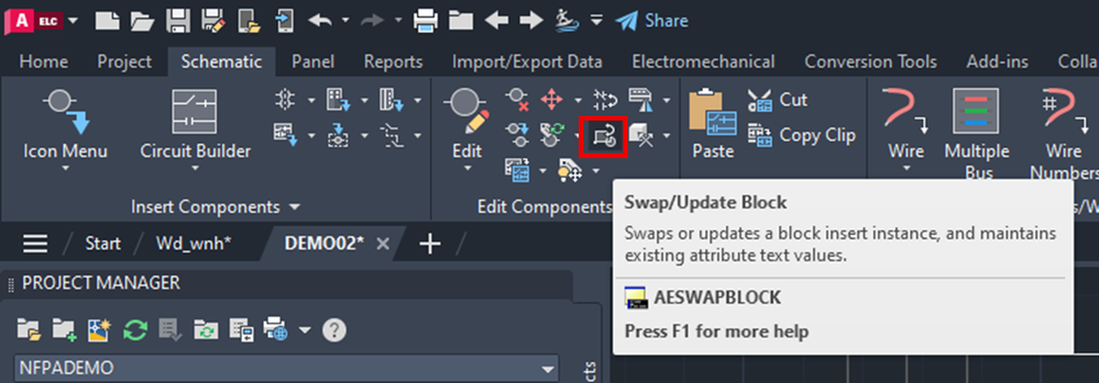

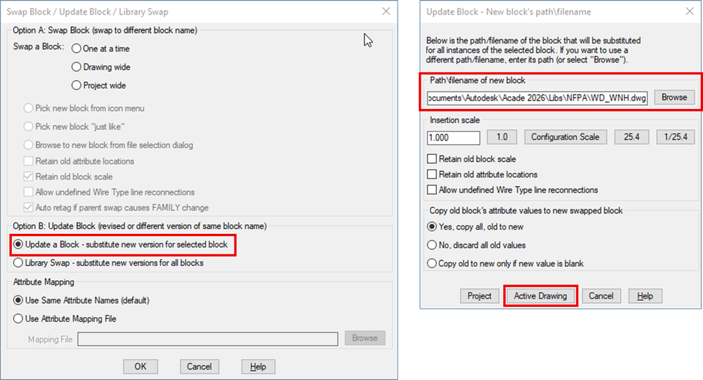

You won’t have any issues if you're inserting the modified symbol into a fresh new drawing. AutoCAD Electrical will load the latest version of the block from disk, including changes like a repositioned TERM01 attribute in the HT0001.dwg square terminal symbol.
However, if you're working in a drawing where this symbol was already inserted, the changes won't appear automatically. This is because AutoCAD Electrical stores the block definition inside the drawing when first inserted, and re-inserting the symbol uses that old definition from memory.
To update the symbol and reflect your modifications, you need to use the Swap/Update Block tool. This tells AutoCAD Electrical to reload the updated block from disk and apply it to existing instances in the drawing, while preserving all project data such as tags, wire connections, and catalog information.
https://help.autodesk.com/view/ACAD_E/2024/ENU/?guid=GUID-4673F13C-93D5-4C74-8F15-77AB8B4EB9EF

If you need to enlarge the wire numbers, you can do it the same way as you modified the Terminal Block.
When you double-click on the wire number, it will show you the block name. (WD_WNH for Horizontal Wire number and WD_WNV for Vertical Wire Numbers)
Just simply browse to the symbol location, open it, and increase the attribute size to your liking.
To update existing wire number sizes on a drawing, perform a swap/update block after modifying the wire number symbol.
