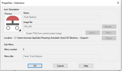

Hello, I'm trying to set up the panel symbol default to be in a network location. I've edited the wd.env file to set the default browse location and that works correctly. But when I click on a symbol in the panel icon menu the default location is still in my C:/ location.
I've even went into project properties and set it to be on the network.
 This is where I set the wd.env file to look for the network location when I browse.
 Here is where I set the project properties to look at the network location on the S drive.
 But when I right click on a symbol in the icon menu I get the local drive location.
What am I doing wrong?

snorcisa7FS8E
Hi Bob,
I did rename the wd.env file on my local drive as wd_local.env.
When I launch AE and go to the icon menu the "browse" button sure enough is looking at the network drive like I want it to.
However, when I go to the icon menu and right click and hit "properties" it's seeing the local drive.
 This shows the "browse" button seeing the network drive.
 This shows the properties of the symbols in the menu being local.
Message 13 of 18

Message 16 of 18
ramesh.kambang
Question is - do you want to move all acade symbol lib (everything) to the server or you want to put only your custom symbols to your server?  you need to modify wd.env file to suit i.e. for .dat files etc
I would keep acade out of the box symbol, libs, images everything in the c drive and I put only the company-specific symbols in the server. This way acade works faster.  In the wd.env file, you should be able to define the location of the icon menu images (.slb) too. see the extract of the wd.env file below:
*WD_SLB,x:/some path/,to override path pointing to ".slb" slide lib support files
Ramesh Kambang
Aerospace System/Design Engineer and eVTOL/EWIS Expert
EASA 21J, UK 21J, MAA DAOS, Certification Specification CS23-29, CS-ANCS, CS-STAN and EVTOL
Please select "Accept Solution" if this post answers your question.
Message 17 of 18
snorcisa7FS8E
Ramesh, I'm thinking we want to put everything out on the network. I'm thinking it would just be simpler?
That being said, I'm on AE2021. I need to move the menu.dat file that corresponds to the symbol library we're using (in this case NFPA) so ACE_NFPA_MENU.DAT into the network location (under AEData?) and the NFPA.dll file and the correct .slb files? What would the correct .slb files be for the panel and NFPA electrical symbols?
Message 18 of 18
ramesh.kambang
It is possible, you also need to modify the wd.env file for libs, database, etc.  The AeDat folder contains only the database, wd.env  and tutorials.
For slid menus see
C:\Users\userxx\AppData\Roaming\Autodesk\AutoCAD Electrical 2021\R24.0\enu\Support
you need to copy .slb, .dll and slide libraries. If you are not sure, I would suggest copying the whole Support folder to a new location. Then you need to redefine the new location of the .dat files via Icon Menu Wizard
