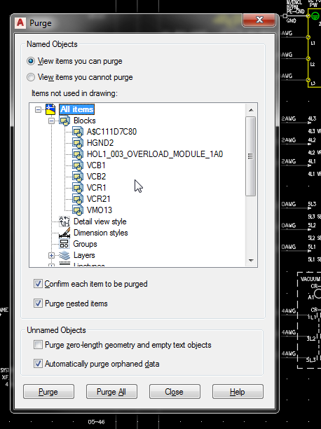

I would agree with jseefdrumr in that I always open the .dwg ( ie file FP_002_LUG.dwg) file of the block for direct editing.  Open the way you would open any other dwg file.  You can do this with standard AutoCad if you wish.  Change the values and setting and position for the attributes you want to modify and Save the file, as in replace the old file with the new. Change the values of each attribute using the Modify > Properties tool.
You can test it by inserting your newly modified block into a NEW clean drawing.  If it works in the new drawing but still acts funny in the old drawing you probably need to run the PURGE command in the old drawing.
You may or may not know that using the Delete tool does not completely remove the block from the drawing.  You need to run the Purge command to completely remove the block.

If it is a drawing you have been working on, and have inserted this symbol previously, then you change the symbol and re-insert it, the old symbol is reference is still used in your drawing?  To use the new symbol you either need to rename the modified symbol before inserting it or DELETE every instance of the symbol in the drawing THEN use the PURGE tool and remove it from the drawing, THEN insert the new symbol.  The ACE drawing will 'remember' symbols/blocks inserted even when they have been ERASED.  If this sounds odd use HELP and search for the PURGE tool
Note that the ACE Swap/Update tool will do all of the above for you automatically.  It just does it so fast you don't see what is happening.
