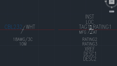

The rating attributes are populated through the TEXTVALUE column. I think the RATING1 attribute is used by cables to show the conductor colour by default and you can use RATING2 and so on for your custom text like lengths.
See this symbol below where I setup RATING1,2,3 attributes in a cable symbol and set the TEXTVALUE field in catalog to RATING2=18AWG/3C;RATING3=10M
Another thing to keep in mind is that you will still need to label the symbols with HW0# and VW0# for the cable functionality to work like reports.
