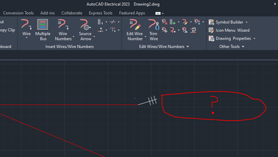

When I put a switch on a wire on AutoCAD Electrical, it cuts off half of the wire for some reason. How can I fix this? See below.
Before:
After: Notice the wire got cut off after switch

It seems like your symbol only has one connection point, on the left side.
Open it in symbol builder and check one more time.
