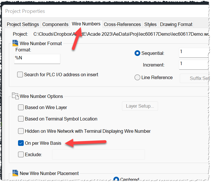

I am designing a wire harness and I want to use the wire label tool to label each wire segment, but it labels the entire circuit/all the wire branches that are connected as the same wire number.
In the attached screen capture, I am using a terminal with wire change, but I need to represent a wire splice of 4 wire segments, each with a different wire segment ID to populate a wire cut list.
Suggestions on how to use the wire number to do this?

Have you tried checking the "On per wire basis" checkbox in the project settings, and rerunning the wire numbering?

Trond's suggestion is really the only way to make this work without a custom solution.
If you are unable to number the wires on a per-wire basis, you may want to consider drawing yourself a custom wire change terminal, and just make it really really small - small enough so that the printed line's weight will obscure it.
I did that for a specific project a long time ago, because it was an as-built legacy project and I couldn't adjust how the wires were numbered. It worked well for that situation.

afelsheimQGEXM
This is exactly what I'm looking for!
Thanks so much!
