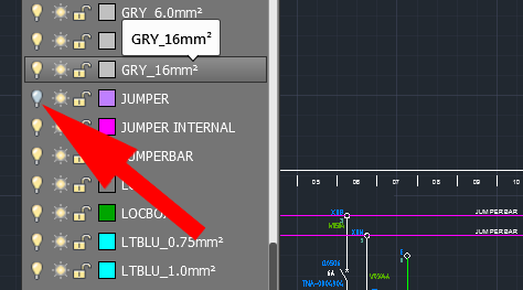

EDIT: having some trouble testing, as every time I try to change a wire to JUMPER or JUMPERBAR, it simply disappears.
Ok, so at some point while importing Wire Types from another DWG or importing layer sets, my JUMPERBAR layer became turned OFF:
I've rerun the Electrical Audit and the Wire Types set to NO wire number are now omitted from the Wire Exception error list! Thank you, Brad
Icemanau
The wire layer would have been turned off when you imported the Layer Set.
When the layer set was imported, it probably did a Restore.
When doing a Restore there is an option to turn off layers not found in the layer state which is selected by default.
Regards Brad
