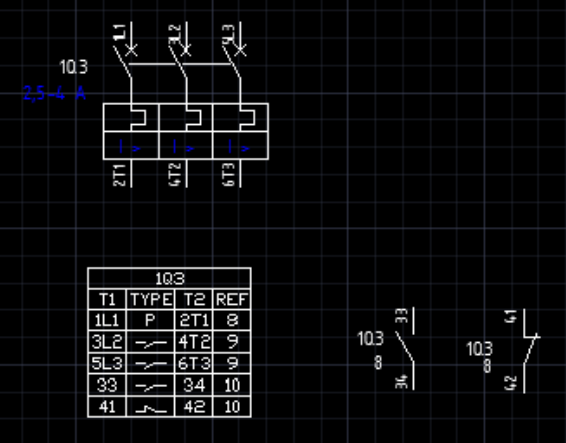

Good day!
In version 2014, the cross-reference table for the circuit breaker and the auxiliary contact block contains 5 rows.
Can I remove the line of contacts of the circuit breaker from the table (the first three) and leave only the lines of additional contacts (the last two)?
In version 2019, the table in this case contains only 2 lines.

Have you tried to add the text NULL in the CONTACT attributes?
https://knowledge.autodesk.com/support/autocad-electrical/learn-explore/caas/CloudHelp/cloudhelp/201...
CONTACT
Attribute that is present when the symbol is a contact.
The value of this attribute is the de-energized state of the contact; NO, NC, or any text string with an
embedded NO or NC such as NO-TC. Use NULL as the value of the contact attribute to exclude the contact
from being included in any cross-reference text annotation.

metal_pro2
Thanks Trond
Using Contact = Null works perfect for only showing the Auxiliary contacts on disconnects
